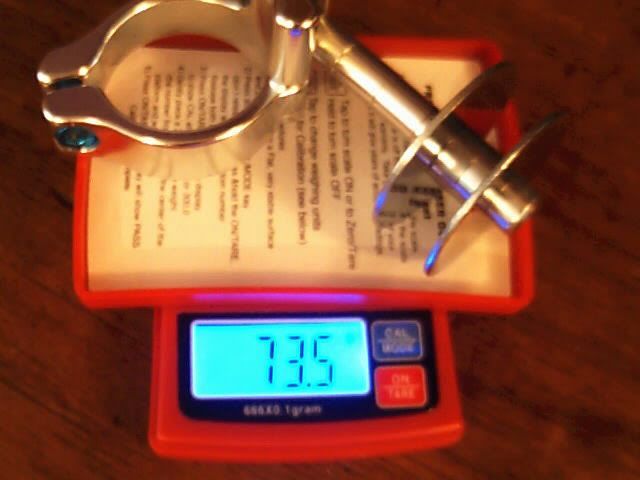

Inspired from a previous thread, I made my own chain device for under £15! It works well (no chain rub at all) and actually looks ok too 🙂
Weighs in at 73.5g. Not the lightest but could be made lighter with alu washers / barrel nut.
Just thought I'd share my info to make it easier for other people that might want to make their own!!!
CSN Clamp for Braze-on Front Mech 31.8mm
£5.25 + 2.95 p+p Ribble Cycles
Alu bolt M6 x 70mm £1.06
Alu collar M6 thread 8.5mm o/d - 10mm length x 3 93p
Alu collar M6 thread 8.5mm o/d - 5mm length x 1 25p
+ £1.99 p+p Tastynuts
2 x 6mm Cup washers (taken from old V-Brake Pads)
M6 Cross dowel / barrel nuts 35p
M6 Washer 40mm diameter (x4) £2.20 Ebay

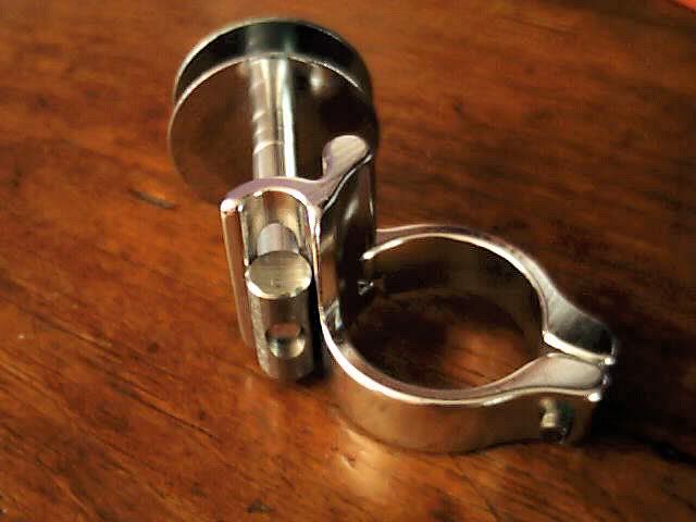

Got the weight down even lower with my second attempt. The steel washers have been replaced with nylon 🙂

Since you're publishing weights...
Why not cut down the washer so you only leave the bottom half (well and the hole obviously) that you actually need?
Or better still, get some nylon sheet and make a proper 'cage'.
Nice work though.
Posted : 04/06/2010 10:56 am
TBH, by chopping the top off the washers I'd probably only save a gram or two. My main gripe before was the weight of the heavy steel washers, but now it weighs a lot less... job done!
Posted : 04/06/2010 11:07 am
Well, for neatness then 😉
Posted : 04/06/2010 11:16 am
Posts: 11
I made one of these a few years ago for an on one & did cut the top off the washers , the problem was that sometimes the outer washer got knocked & turned , making it less effective , & looked silly which was more important.

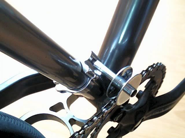

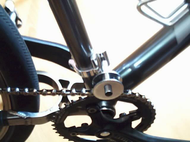

Excellent MacGyvering, well done.
Any chance of an in-situ pic?
Posted : 04/06/2010 12:00 pm
Here ya go!
[img] ?t=1275651780[/img]
[img] ?t=1275651814[/img]
Posted : 04/06/2010 12:45 pm
Posts: 78916
Sweet (-: That's awesome.
