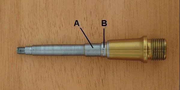

I recently bought some used Triple Tis on ebay, when they arrived they had a worrying amount of play in the bushes. Emailed the seller who said "I thought I said they needed a service". He hadn't said anything of the sort. Thanks. But no big deal, I'll buy a service kit, it's only £15 and that should sort it out. Once I took them apart this is what I found:
Part "A" is where the bush runs and should be the same diameter as part "B". The nylon bush has worn away the Titanium axle. Amazing.
So I double-checked the pedals on my other bikes. A pair of Eggbeater C that I've had a while but not used all that much, maybe a dozen short rides, so probably less than 200 miles and they have some play in the bushes. And the other set, a pair of eggbeater SL that I know for certain have been used [b]once[/b], for 20 miles, on a road bike, in the dry and they have play in them too.
I know they're a minimal design and might need a bit more attention than something from Shimano, but seriously, new bushes after twenty miles ? I can only assume they're meant to be like this and you literally run them until they fall apart.

unless CB have changed the design such that the spring mechanism is part of the body, completely isolated from the axle, many of their problems resulting in a high servicing requirement will persist as the pedals get older. once the seals between body and spring mech have deteriorated the crap will get to the internals. it was never a problem that they used a bush on one end - in fact time do just this.
Posted : 18/09/2011 9:36 am
Posts: 71
They have. The body is now water tight and protects the internals.
